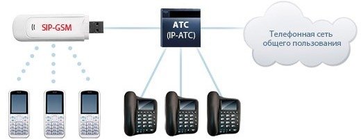

Oktell SIP-GSM (freeware) should give you an idea of what I am talking about. Unfortunately, it doesn't recognize my voice modem!
3CX Phone System <=> [Some software VoIP gateway solution?] <=> GSM Voice modem
