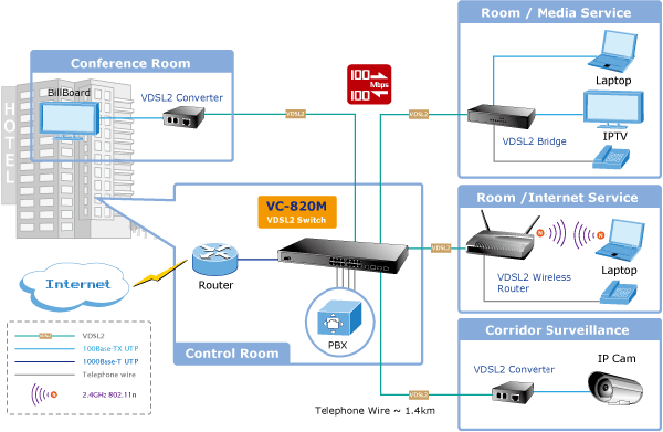

    It might be good to use cable raceways for Ethernet in selected rooms which some guests may like to use.
    Even in that case, analog phones can be used with addition of SPA122 ATA with Router.
    Well equipped rooms will have IP phones and STB for NASA TV 4K channel!o_O
    Hopefully, @Silly English Kniggit will realize why it's important for 3CX to support such equipment.
    [​IMG]A small
    form factor DSL modem is placed in the guest room to convert the DSL signal to Ethernet and WiFi which is
    then connected to the CPEs (customer premise equipments) in the guest room including set top boxes,
    personal computers and IP phones...
