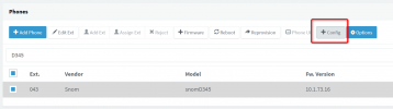

Go to Phones page, select one of the D345 that you have already changed the interface (like we discussed above) and then click on the +Config button

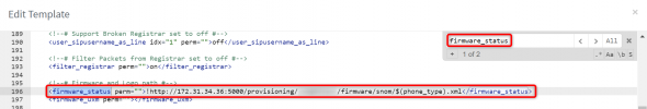

Now click inside the template box that will appear, press Ctrl+F and search for firmware_status
Does this show the correct interface here?
in this file, the right interface is used:
Code:
    <firmware_status perm="">!http://192.168.20.251:5000/provisioning/<random>/firmware/snom/$(phone_type).xml</firmware_status>
But when I download this xml file
http://192.168.20.251:5000/provisioning/<random>/firmware/snom/snomD345.xml
I get
Code:
<firmware perm="">http://192.168.1.142:5000/provisioning/<random>/firmware/snom/snomD345-10.1.73.16-SIP-r.bin</firmware>
which is the wrong interface ;) In fact, this file is the one I saw in the backup.
So, the main provisioning xml file has the right interface, but the firmware xml file is hardcoded to the main interface it seems. Probably one solution whould be one firmware xml file per interface.
