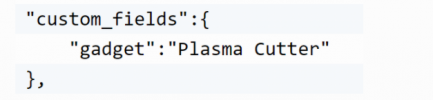

to add to this, Freshdesk's API documentation says you need to declare it's a custom field then put the relevant field / string, but how would I do this on the XML?
Normal field
"subject":"Support Required",
Custom field
"custom_fields":{
"gadget":"Plasma Cutter"

In the XML template therefore, how would I write it so it would output like the below in JSON?
This is how the CreateTicketForCall scenario should look like:

that is perfect! worked exactly as expected - issue was on the response I was getting custom_fields.cf_category so I added in a value, not an object.
that's great, thank you so much for your help!
