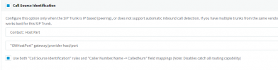

Hi @philsummers
The only way I can think off of doing this is adding each SBC as a separate trunk in 3CX and adding all DIDs in each trunk. You will also need to create each inbound rule twice to accommodate for each trunk.
The trick is for the PBX to be able to determine the trunk the call is coming to. To do so you will need to determine the correct settings for call source identification.
So lets assume that each SBC has a different IP address and that IP address is present in the Contact header for inbound calls.
So the 2 SBCs will use different IPs in the contact header. You can then navigate to the Inbound parameters of each trunk and set Call source identification like this:
This will tell the PBX to match the call using the IP in the contact header and also look at the DID.
You need to check both options in your scenario to be sure that the call will be matched with the correct trunk and you will need to do this for both trunks.
There are other SIP headers you can use to help the PBX distinguish between the 2 trunks so you can play around with it.
Hope this helps
