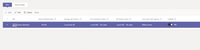

Hi!
i see that the tls connectivity status is LOCAL SBC - no data, is this normal?
This is most likely because you just created it and there is nearly no usage yet
After you configure the users and start making a few calls consistently over the period of a few days, yes, this should change.
For the time being, you can ignore it and just have a mental asterisk to check it in a few days.
