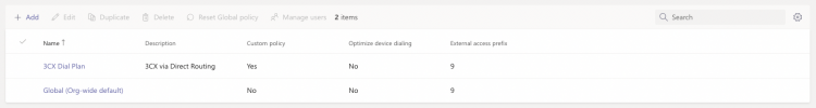

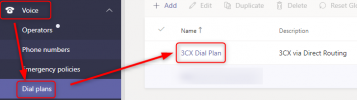

If you log in to the admin portal (admin.teams.microsoft.com) and navigate to Voice >> Dial Plan >> 3CX Dial Plan, can you open the 3CX Dial Plan and send us a screenshot of what you see?

Hi @infinity5,

Firstly, can you edit the Dial Plan and remove the External Access Prefix while we test?
Can you open the dial plan by clicking on the 3CX Dial Plan link and sending a screenshot of what you see there?
Hi @VasilisV_3CX
Yes I have edited the dial plan and removed the External Access Prefix as requested.
Also here is the screenshot, I assume you only needed the Normalization Rules.Screenshot 2021-08-24 at 14.12.13.png
