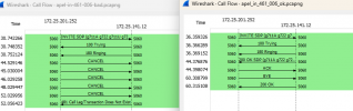

Hi all,
We did a port mirror of the port where phone is connected.
We have wireshark trace for a call that was ok and a call that was bad ( when call comes into Fanvil it reboots, this is our observation). So, doing packet capture on phone is not an option since we loose a connection.
Call was made from extension 461 to ext 006.
Left side: bad call
Right : ok call. ( fanvil sends 200 ok and all is good)
201.252 - 3CX
141.12 - Fanvil phone.
We have logs and config file.
Can you imagine what can cause this?
