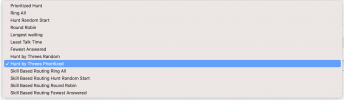

Currently we use "Hunt by three prioritized". If I switch to "Prioritized Hunt", does it work? (As only 1 agent is notified at a given time? eg. 20 seconds?)

If only 1 agent's extension rings, then the call will be notified, otherwise it will not.
