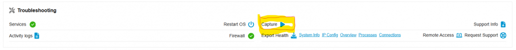

Hello Nikos, My understanding is that with a hosted 3cx instance I have no access to the OS, is that correct? Or can I collected the pcap via the 3cx console?
To clarify, 1 of the 2 trunks is working from the new hosted instance. We've already updated the whitelist, both of the trunks are with Gradwell under the same account, so I would have assumed if 1 works, so would that other.
You can initiate a capture from within the 3CX PBX Dashboard:
The expectation would that your new IP was whitelisted for both accounts, but only Gradwell can confirm that.
