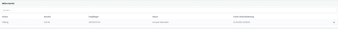

yes just tried to call from a second extension to my Teams User and the call is still active.
The interesting point is if the call is active you can the call on the dasbhoard:

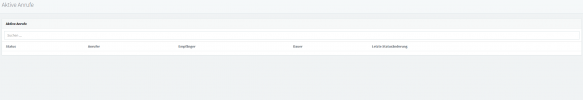

As soon i'm hanging up the call the active call dasboard is clear but Teams still recognizing as active:
So from technical aspect i think it not SIP Provider problem because the probleme is still there if im calling from extension but looks like it's a SIP Communication problem because as i know SIP is responsable to inform the clients the signalation.
