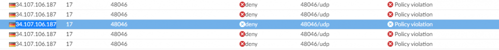

The problem mentioned in the previous post (https://www.3cx.com/community/threads/mcu-servers-list.113300/) is not solved.
We did tests with some customers, and they cannot access the webmeeting yet.
As you can see in the image, the actual ip is not listed in this fqdn. Do you know when will this work?
thanks,

Hi!
one of our customers report that it is not working, there are ips that not appear in this dns record. As you can see in the images below.
This error happened yesterday at 9:17 CEST

Hi Leonidas,
no, we don't have any dns cache, and here are some test made this morning, from 9:24AM to 10:45AM. The mcu of our webmeeting test is 34.159.75.48
1. 1 nslookup to 8.8.8.8 and 7 minutes later another to 1.1.1.1
2. mxtoolbox at 10:00
3. nslookup using wireshark to view connections at 10:40
and as you can see, the actual ip doesn't appear
thanks!
