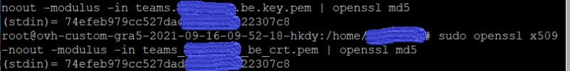

3. Check the Key and Cert file with openssl command and results are identical:
Certificate is not a wildcard and come from ssl.com
