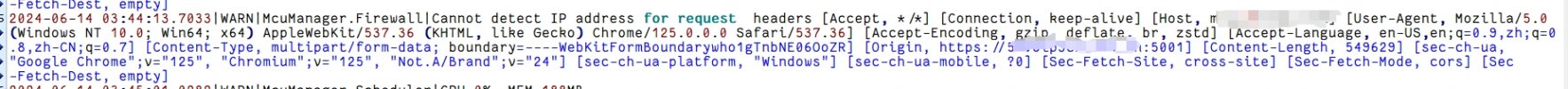

We updated to V20 update 2 for testing. We enable the Private Video Conferencing Server. We can use the video conference, but We can't send files in the chat box.
The following picture is the 3CXMcuManager.log.

Hello, thanks for reporting this problem. There is an issue with .deb packaging which has been fixed. You can update the MCU on your server just like any other debian package using
sudo apt update ; sudo apt -y upgrade
or if you prefer you can uninstall, delete the onboard MCU, create a new one, then reinstall.
The correct MCU version you should see in UI is 20.0.1.35945.

Thanks for your reply. I can send files now.
