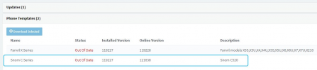

This is actually available now on 3CX v18.0.1.237. Just go into the updates section and you should see a template update for the C520:
You will of course have to reprovision the devices after you've downloaded the new template.
