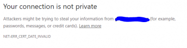

When I use Chrome (Version 96.0.4664.110 (Official Build) (64-bit)) I get the following and there is no option to continue. A work colleague with the same version of Chrome can login.
With Edge (Version 96.0.1054.62 (Official build) (64-bit)) I can see the admin screen.
Both are reporting SSL expired.
