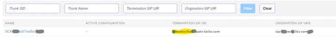

Did it ask you for a Trunk name? If yes you need to put something unique/descriptive as Twilio creates a FQDN with that and if someone already has used that name it fails - so just calling the trunk "Twilio" will not work.
Twilio interface: Yellow is where Trunk name goes -
I fixed it! I realized that the phone number and trunk are separate entities in Twilio and not created together. I was able to delete the trunk successfully.
