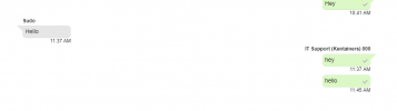

I'm running self hosted Windows 18.0 Update 9 (Build 31). When we respond messages, their not being received/delievered. Blue ticks and double ticks are also not there. This began last Thursday.

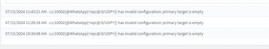

Below is a snippet of the Activity Log
This does not mean that there was no change in the configuration.
Check the guideline and ensure that all is configured properly or try to re-create it.

I did recheck. In fact, I completed recreating it, about an hour ago.
I've another WhatsApp trunk running on Debian 3CX v20, and it's wotking fine. Anything you might be aware, or want to recheck, that happend on Windows?
The error indicates issue with the connection or configuration.
Is your number in E164 format?
