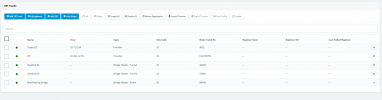

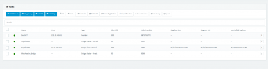

Svjetlost ZG is system A, Svjetlost BiH is system B. When they making outbound call over system B to their client, and client make redial, they making call to System A, and it shows caller ID from System A to their client.

Could it be that the provider in the country where "C" is located has recently become more strict, with the caller ID being sent?
If you check the 3CX Activity Log (Verbose), for one of these calls, what caller ID does it show being sent? If it is (what you consider to be correct) from the originating PBX (A or B), then I would have to assume that it is your provider that is making he change.
I see that you do not use a prefix to call between the 3 systems. Do all systems have different extension lengths or are in different number ranges? You may need more strict outbound rules so that calls always go out the correct PBX.
