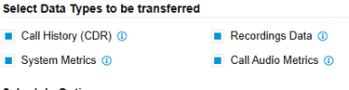

These options are selected:
No system metrics data is exported.
