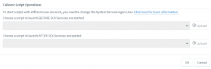

The PBX can run any script you want during failover event, so you can write a script to update DNS when failover happens
