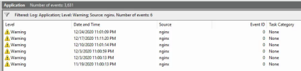

This started about a month ago where after a reboot of the phone server the actual Nginx web server service isn't starting like it is supposed to. I can manually fire off the service no problem and then the system is accessible again. Looking through the event logs shows the following but I'm not sure what it means.
Child process [3576 - C:\Program Files\3CX Phone System\Bin\nginx\nginx.exe "-pC:\Program Files\3CX Phone System\Bin\nginx" ] finished with 2
Any assistance is greatly appreciated.
Thanks.
Ryan
Change the service startup type to ‘automatic delay start’ , to see if resolves the issue.
If not, look at the recovery tab of the ‘ 3CX PhoneSystem Nginx Server’, to restart the service after a failure
That worked great Saqqara, thank you kindly!
