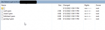

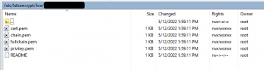

I'm not sure what it doesn't like. I had a random thought but I've never heard of an application being able to make the distinction, but LetsEncrypt uses symlinks for the "live" directory. Could the installer be reading the path and seeing its a symlink?
Where the xml points (and where configs should look)
Where the actual cert lives (on the other side of the symlink)
I could of course feed the XML the archive path but in 90 days or whatever the cert will expire and rather than the symlink updating to the new target cert, we'd have to script that too. Any ideas on this one (other than just use the free domains from 3CX sorry but that isn't even a remote option) ?
