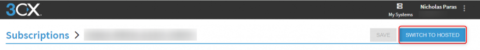

Once you include 3CX hosting in the subscription, it will not automatically migrate the machine. You will need to do this through your customer portal, by clicking on Switch to hosted.
or if you go into the subscription itself
