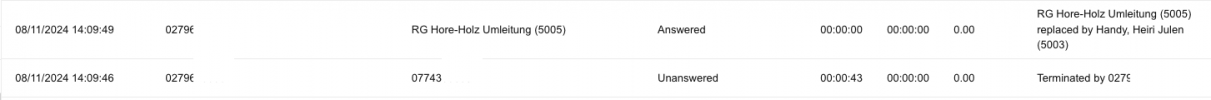

When redirection to an external number is enabled on the phones, they fail to redirect the call and keep picking up the queue call, until on one case queue waiting times out and sends the call to a RG.
On the one case In the screenshot, you see the phone is trying to pick up the call for 15 seconds, when the queue waiting times out.
On the other case, what happens is that the external number rings once and then goes straight to voicemaill, since the phone tries to connect again to a line that is busy with the first instance of the same call... (hope that makes sense :))

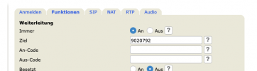

Thank you for your replies. The phones are hotel receptions phone.
During the day they ring normally for incoming calls through a queue.
At night the staff use the Snom function keys to divert calls, either to Digital Reception or mobile number of night staff.
In the morning the redirection is deactivated on the phone to resume normal operation.
This has been working fine for years, telephone picks up the Queue Call and depending on the active redirection, sends the call to an IVR or an external number. Now since upgrading to v.20 the redirection to an external number doesnt work.

I will repeat my previous response. These forwardings should not be done from the phone. This is to acommodate SIP forking where you have multiple devices on the same extension.
The forwarding should be done from the the 3CX Forwarding rules. And in the queues the forwarding rules are ignored in most cases.
