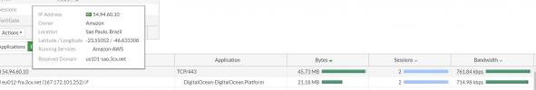

And analyzing the sessions on my firewall, I noticed that the meeting I open here is pointing to a server here in Brazil (São Paulo), but your meeting points to a server in Germany (See the last image). I believe that the server in Brazil needs to be updated.
WhatsApp Image 2021-03-25 at 08.30.42.jpegWhatsApp Image 2021-03-25 at 08.31.08.jpeg

The server I connect to shows that the server version is 1.0.0.0.
I believe that when updating this server, the problem will be corrected.
As the image below.
