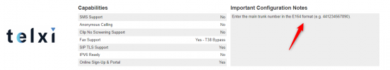

Hi ive set up a sip trunk for telxi ive made a ring group etc . However, calls go striaght to vm but show on logs as missed calls . when making outbound calls it says number is not recongised
Check the following
Important Configuration Notes​
Enter the main trunk number in the E164 format (e.g. 441234567890).
Check the following
Hi do you mean under the did number section in the sip trunk ?
yes
I have this as 2 did number one is +44 and one is 07. The sip register shows the number as just 44 but 3cx won't accept this

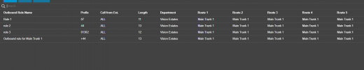

Hi yes that was the problem for inbound calls what do I need to have set up to make outbound calls
I'm not aware of the dialed numbers however they seem to be OK.
