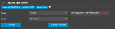

Hi @Hem
Can you show us a screenshot when you set the filter like the screenshot below?

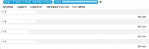

The first screenshot shows the filter and output configuration that fails to produce results. The report is set to a single-day range—specifically, October 10.
The second screenshot displays a filter configuration that successfully retrieves data, but it only returns results for October 10th.
Hi @Hem
You are right, it seems to be an issue with custom range filter.
If you need to use a custom filter use whole days (i.e 10/10 00:00 - 12/10 00:00 which should show 10/10 and 11/10)
Thank you for reporting this, it will be fixed in Update 8.
