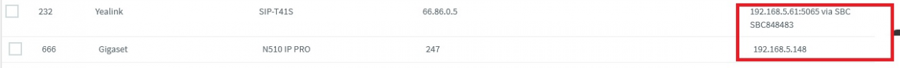

It's correct that I don't see in my phones list on 3CX that it is connected via SBC?
You should see all phones with an active registration on the phones tab. Including phones connected via SBC
What I mean is It's in the phone tab but not with the message via SBC, is that correct?
I'm not 100% sure here, as I don't do unsupported phone via SBC (I do them via VPN/LAN always), but I suspect if it doesn't show via the SBC (the the via line) then it's not using the SBC and instead it's using Direct SIP (often called STUN on the forums).
Look for the outbound proxy settings in the device. Put the IP of the SBC and port 5060 there.
I enabled "block remote phone" and it's still working, so it has to go through the SBC. It just does'nt show it in the phones tab.
