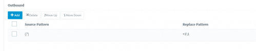

Next I just want to explain what this "Outbound" section is meant for. This is for when you may have an incoming call from Provider A and you want to Forward it out through Provider B but present the Originator Caller ID as it came to A, but B (as in your case) requires the Caller ID format differently that what is presented.
Enough theory though, practical now. Specifically for Amazon Chime, yes it is possible, because the reformatting happens on outbound parameters that are set to "OriginatorCallerID".
Because it is possible for Amazon Chime, don't assume that it will be possible with all providers, because not all work with the same Outbound Parameters.
Something like this works fine:
What it does:
Prepend +1 in front of any Caller ID number.
So, if in your extension you put outbound caller ID 2025550145, with this rule in the packet capture you will see in the 'From' field +12025550145.

I was doing this way different as you seen in my example. I will go ahead and give this a try and report my findings here tomorrow.
Nick,
This works. Really thank you for your help again.
