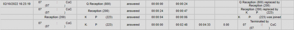

When we look at the call details report for a call which worked fine we always get the below four steps (names and numbers redacted):

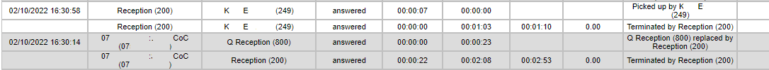

However, the call in question shows the below:

The second thing is that, looking at the second screenshot, I can't actually ever see the external caller being connected to the second extension. It seems as if the external caller got connected to the queue and then the reception extension(200), and at some point the reception extension(200) just made a new call to extension 249.

I agree with what you say about not seeing the second call. The only point I did spot was that the first call came in at 16:30:14 and lasted for 2 minutes and 53 seconds, with the second call starting at 16:30:58 (hence overlapping)
