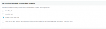

For the agents we have the following settings
So they're unable to toggl the recording button when they speak to an external number.
I've checked to see if the recording exists on the server and it doesn't, the only recording I can see is the first conversation between the customer and 1st Agent. We should also be seeing a second recording between the customer and the 2nd Agent.
