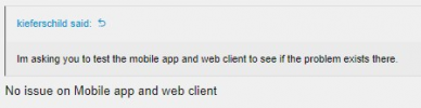

Im asking you to test the mobile app and web client to see if the problem exists there.

Yes before there was an issue with mobile phones and WebClient but now the issue on 3CX Desktop App .
