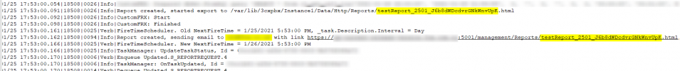

This is really strange. You could check the logs to see this. Just put the 3CX system in Verbose from Dashboard --> Activity Log --> Settings.
The wait until a scheduled report is send to someone. If the issue happens, from Activity Log --> Logs --> Instance, open the "3cxSystemService.log" file and look for a line like this:
For each triggered scheduled report, it tells you the local filename, the email is sent to and the HTTP link that is generated.
Could you check this way to ensure that there is not any confusion going on?
