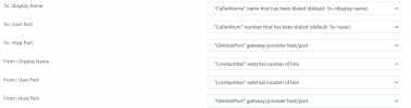

Also check the Outbound Parameters for the SIP trunk itself, but be careful with what you do there.
Take a screenshot before you start anything.
What needs to be done with outbound parameters?
