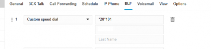

Hey everyone,
Having some issues with call pickups via the BLF key. I've got the below image set for a user, using the *20*(extension number), however when users try to use this, they get a "Call Transaction does not exist". Does anything else need to be enable to allow this to be done? Also a side note, can this BLF key also be then used to call other extensions, or would I need two seperate ones, with one as a normal speeddial, and another as the custom speed dial.
Just use a regular BLF. If the user is ringing, the BLF will blink red and users can simply click on it to trigger the call pickup. Obviously, sufficient rights are needed.

Ahh ok thanks for the info! I was under the impression that the *20* was still a thing from some other forum posts I've seen. I'm assuming Reception and above roles would need to be added? I believe the users did try, but only had the default user role when they mentioned it not working.
