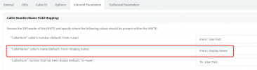

The first thing you need to do is to see in which SIP field the callers name is included when it hits the 3CX PBX. Then you need to set your Inbound parameters of the trunk to read the correct SIP field. In my example the callers name is included in the From: DisplayName so I have the trunk reading this information from there.

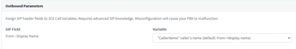

Then you need to set your Bridge to also use the same Variable
The PBX will use this information and will send it across the bridge in the Remote Party ID SIP header so your Asterisk needs to read the callers name and caller ID from the Remote Party ID SIP header and not from the From header which is used by the PBX for authentication purposes.

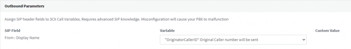

If that is the case then the above apply you will just need to locate in which SIP field the caller ID is included when hitting the PBX and set it up in the Inbound parameters of the trunk in 3CX. Then in the bridge settings you will need to set the OriginatorCallerID variable
Again you can read it from the Remote Party ID SIP header in the Asterisk side.
