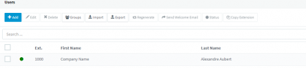

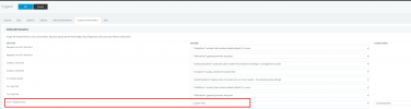

I got a customers who have multiples divisions on the same system ; they want to be able to change the Caller display name by division but they are using the same Trunk. Without getting multiple trunk is there a way to pass Display Name by caller id. I'm forcing display name with custom field usualy ; for this customers I did put Caller Name and put the Company Name on the First Name of the users but is there a better way to do ?

- The current configuration allows you to control the name viewer yourself (we will use what you send in the SIP prompt in the From part in quotes)
