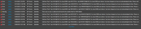

Hello, we have a customer on a free version with 3 Fanvil handsets and they have been getting the following fault:
Call from "Rec2"<sip:[email protected]:5060>;tag=2293035928 to <sip:[email protected]:5060;user=phone> has been dropped as it was not acknowledged in time. Please verify configuration and ensure there are no connectivity issues.
Error 50029.
SIP ALG is off
No port forwarding setup on the router
SIP trunks are with a service provider that we have other accounts with, and they are all ok.
Can't look at the raw data on the free version so, I'm not sure what the issue is? any ideas?

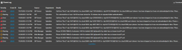

Please have a look at the Event Log

Hi, the problem is still there. It's only on outbound calls. Could this be a coded issue?
I have rebooted the Router phone; I have rebooted everything. From the list above you can see somedays you get more faults than other days?
