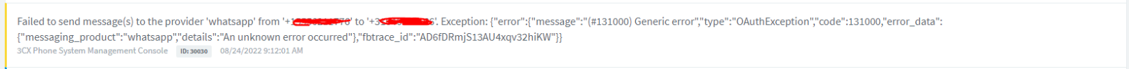

I can recieve messages perfectly fine, but I can't send anything back. it instantly gives a red cross when I try to send the message.
If I look in the event logs I can see the following:
Is there anything I do wrong, or do I miss a setting? My PBX runs on 18.0 (Build 384)

Hi Jasper,
It appears the message you tried to send was rejected by Whatsapp.
Was this just a plain text reply or did it include anything like file attachments?

Thank you for your reply, it was just a plain text reply.
