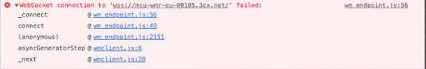

Hi, Nick.
This is what appears in the console upon clicking the "Join" button.
Here are the detailed views of each line:

Hi there,
If you perform an nslookup from your current computer like this, what does it return?
nslookup mcu-wmr-eu-00105.3cx.net
I've performed a test and was able to connect in a meeting on this MCU server from my location. I suspect that perhaps you're not able to resolve the IP correctly. By the way this server is hosted in Google. Are you in a location that blocks Google services?

Well that's correct. Resolving the server is fine.
The server seems to be operating fine so it's not an issue there. Do you have any strict firewalls/antiviruses that might be blocking something?

We're going to look into this today on a similarly configured system and get back to you. We recently updated our certificates. That's the only thing i can think of that could be the cause of the certificate store on that machine not being updated & thus not recognizing this certificate or restricted cipher suites on that O/S or machine in specific.

We have done some investigating since yesterday and we know now the exact cause of the issue.
Recently we have update the certificates on our WebMeeting servers (V16 and V18) as the old ones were close to expiry. This has caused browsers running on older OS, like MacOS 10.13.6, to stop being able to connect to 3CX WebMeetings.
The solution to this is to advise the users to update their OS to the latest version of their OS that is released. Note that in the case of Mac, we are aware that some older hardware may not be able to upgrade the OS, but unfortunately there isn't anything we can do. This affects both Organizers and Participants of meetings.
For MacOS users, as a workaround, they can try downloading and installing Firefox 96.0.3 or newer, as this browser does not use the root certificates of the OS and has it's own list. This though is a workaround, so if this does not work, the solution in the previous paragraph needs to be used.
