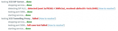

Se implemento un PBX en un equipo Raspberry, la version es la 16.0.8.9 actualmente las pruebas de firewall indican que solo el puerto 5090 tiene un problema llamado "full cone test failed" y que el SIP ALG Server envia un error llamado "detected (sent 3a7f6582 ≠ 308fe3a1, received cdefec09 ≠ 6e5c3049)"

Regarding the issue, it would seem that you have SIP ALG enabled on your firewall and that TCP and UDP Port 5090 are not forwarded to the 3CX PBX.
The 3CX Mobile Apps use the 3CX Tunnel connection which in turn requires TCP and UDP Port 5090 so it would make sense that you are having issues with these clients if those ports are not configured correctly.
Make absolutely sure that all ports mentioned here have been configured: https://www.3cx.com/docs/ports/
You might want to also check our "Firewall Configuration" guide which mentions that services such as SIP ALG must be disabled and also contains links guides for commonly used firewalls: https://www.3cx.com/docs/manual/firewall-router-configuration/
