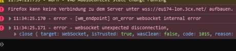

In testing we had issues with the meeting app on iOS and Android, it will stuck on "Authenticating". Then I also found out that Firefox is unable to connect, while Edge and Chrome work fine.
There are websocket errors like this in the dev console after trying to connect:
Now this is a London UK location .. which is fully allowed by our sophos configuration.
Now the funny thing, I go to Conferencing Settings in the 3CX Administartion and switch the Region from Europe to United Kingdom.. THEN it works on the App and on Firefox..
I tried to switch back to Europe.. the error happens again..
Do you have a clue why its not working on Europe Region after switching from https://... :5001 to https: 443 ??

Hi!
This looks to be the V16 WM Server still trying to make a connection to your system, because that is how it used to work in V16.
Now of course that you are on V18, this is no longer required.
This also explains why it is contacting you on the 'old' port.
There is not a lot we can do about it now, but on the 30th of March when the V16 servers are turned off, you should see this stop happening:
https://www.3cx.com/blog/news/v16-web-meeting-eol/
As this is the V16 server, it should in no way affect you being able to have and create new meetings.

Ok but we already upgraded to v18 in November 2021. There are still strange connections that I have probably eliminated with the region change?
For what reason is this setting still in the config?
So there is no disadvantage to just leaving this on UK?
Thanks for the quick response.
It's not something in your config, it's just the V16 hosted server by us that is trying to reach out to your system and failing.
This though is a server from the old V16 infrastructure that you don't care about any more because you have upgraded to V18.
The V16 infrastructure will be shut down at the end of March, so then you will stop seeing this message.
No, you can choose which ever region you want, note though that users you invite to your Meeting will be using MCU servers hosted in the region you choose, so it is usually recommended to choose a region, not necessarily close to where your server is hosted, but where the most of your users that frequently use WM are located.

But Europe doesn't work correctly as I mentioned. The Android and iOS Apps can't connect anymore and Firefox gets an error too.
All our users and customers are located in germany, so it would make sense to use Europe again.
Is it possible that there is some missconfiguration / cache problems on the MCU? I had to made a fresh installation and do the init setup (because of update to 314 to import my backup)
You mentioned that you have a Sophos Firewall I think, are you blocking any specific traffic on it that could be affecting?

Thanks, I scheduled the change at 12:15 for our employees (as running webmeetings disconnecting)
I have indeed some blocking rules on the Sophos FW and I disabled them temporarly on saturday in case its their fault, but it didn't changed anything. (3CX Firewall test is green btw)
I'll send you additional configuration details and your account via PM.
I have now set Europe as the region. It seems that the MCU connection has healed itself, seems to have been a cache problem indeed.
I'm still running more tests, but the Android app is also working again.
There are still errors in Firefox, but no more weird connection to London.... and no websocket error
