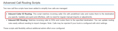

With update 5, we will be introducing a native script for this
https://www.3cx.com/blog/releases/google-workspace-integration/
