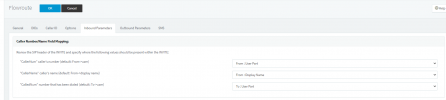

Thanks for the reply, @Charles_3CX. The link you provided seems to be specific to Bandwidth configuration, and it mentions nothing about DIDs. We're using SIPTrunk.com (Flowroute), and their documentation advises changing the inbound parameters: https://support.siptrunk.com/hc/en-us/articles/15073951631899-3CX-V18-and-SMS.
If I can distill this issue down to one question, how do we get voice call routing to go to the extension using an e164 format instead of a wildcard format? If that can be answered, I believe that would address all of the concerns.
You would need to check the inbound parameters of the SIP trunks settings to ensure they match the screenshot below and ensure that flowroute sends the number in the 'To user part' of the invite header in E164 format. You can check under the flowroute portal for this part.
But that contradicts what they have in the document link I posted:
The default settings are as per the screenshot in my last reply, the guide you are checking from in not a 3CX guide and is from a siptrunk.com and not flowroute even, which is also incorrect.
Changing the "CalledNum" value in the trunk from Request Line URI: User Part to To: User Part resolved the issue.
