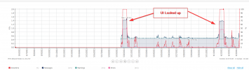

What headset is your client using @misok ? Granted it seems like it's just BT being enabled. I attached a graph of one phone I'm watching to show two UI dumps. Though there is no correlation to a pattern yet either. As some other phones have dumped twice in one day. Did you also open a case with Fanvil as well? Maybe if we can get enough people poking them to look at it and figure out that maybe if a device is paired, but then is no longer paired it will cause it or something as i'm not 100% that is it yet. But maybe there is something silly like that as the cause.
