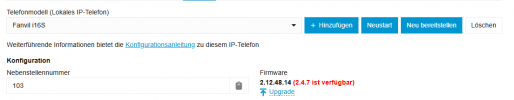

After adding a Fanvil i16S to a Version 20.0 Update 5 (Build 551 Release) 3CX. The system suggests a downgrade to firmware 2.4.7 but 2.4.7 only supports TLS v1 which is not supported anymore. After downgrading as suggested the device needs to be reflashed with a current version using an old browser that still supports TLS v1. This is a supported device so please distribute a firmware that actually works.

Same problem here with Fanvil i10S:
Hi @cniccolo and @fxbastler
The firwmare that are seeing is the currently supported firmware. However we have already received a new firmware from Fanvil which we are currently reviewing and will be released soon.
The newer firmware will have a higher number than the one you currently have so you will be able to update.
You should avoid updating to the currently proposed firmware (2.4.7) for now.
