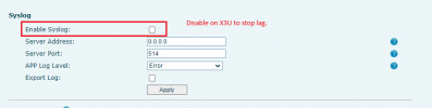

Thank you very much for the quick response. I registered the X3Us via SBC router phone (Yealink T46U). That other post about the X4U-V2 does sound very similar to my situation. Ironically I have some X4U-V2s running on the same PBX, and they work great! I'll give the "stdout" change a try. Cheers.
Based on the other post about the X4U-V2 lag, I decided to disable syslog all together, and the X3U phones started working. They've only been online for a few hours, but they are working great so far. It seem like syslog may have been making them lag. My other Fanvil models had syslog disabled by default.
