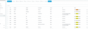

I then found this in the 3CX phones tab (see attached image)...8 Fanvil phones all of different models (but similar first 6 digits on MAC for 7 of them) claiming to be ready for adoption (plus one generic "IP phone").
This is the only Fanvil on our LAN, so I have to wonder where these random models are coming from.
Is the desk phone crashing and sending out different model requests (even though they don't share firmware versions), or are these REAL phones from other companies talking to our LAN SBC over th einternet??? Worrying.
To finish it off, The actual model and LAN IP of the X4U-V2 aren't even in this listxD
