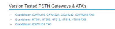

Note that Gateways are not supported, for those issues you should contact your provider first.

The steps provided from @SweetAction are the correct. Note that we do not provide support for Gateways as it is also mentioned in our Support Procedures.
